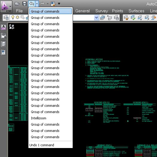

CyberAngel Posted April 16, 2013 Share Posted April 16, 2013 Just now I moved an object. I panned and zoomed to see how it looked. I changed my mind and tried to undo the move. I had to undo dozens of phantom commands (listed as "group of commands") to get back to the move, when I should have had to undo only a couple of real commands. This is not an isolated incident. Looking at my Undo log, there may be no phantom commands for one real command, for another two, for another fifteen. There doesn't seem to be any correlation between the type of command and the number of phantoms. Is this something only Civil 3D does? Do I have a gremlin? Quote Link to comment Share on other sites More sharing options...

CyberAngel Posted April 17, 2013 Author Share Posted April 17, 2013 I'm not sure I've seen that. Can you post a screen shot of the command line text history? The command line history wouldn't tell you anything, unless you want to see bunches of Us. The undo history shows commands separated by "Group of command" (see pic). I had just opened that drawing. I used the mouse wheel to scroll in and out a few times but didn't use any commands. A search of Autodesk community reveals many of the same complaint for Civil 3D 2012 & 2013. From some of the problems described on Autodesk, almost sounds like the mouse software interaction with Civil 3D is the culprit. Are you panning and zooming with the mouse wheel? Yes I am. You have to wonder why using a mouse in Civil 3D is any different from using a mouse in vanilla AutoCAD. Well, we'll have to chalk this up to another "interesting feature" of AutoCAD. Thanks again Autodesk. Quote Link to comment Share on other sites More sharing options...

CyberAngel Posted April 17, 2013 Author Share Posted April 17, 2013 I don't know if this will help but have you tried setting the option to "Combine zoom and pan commands" to on? It's on the "User Preferences" tab in options. I had that turned on. I turned it off, but I still get the phantom commands. Thanks for the advice (not sarcastic this time). Quote Link to comment Share on other sites More sharing options...

CyberAngel Posted November 9, 2021 Author Share Posted November 9, 2021 I noticed this was still happening. It seems to have started with the 2014 edition and has not been fixed. According to this post, the problem may be associative hatches (???). I tried un-associating all my hatches and it seemed to work, but then I had no associative hatches. I guess the problem becomes, would you waste more time undoing phantom commands or editing hatches and their borders at the same time. Quote Link to comment Share on other sites More sharing options...
