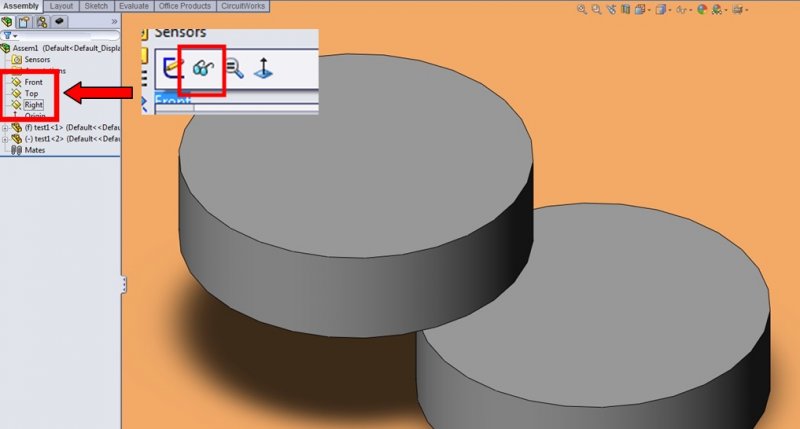

@jiggly - you can show / hide those planes by right clicking on it under FeatureManager of SW then click on the eyeglasses icon to show/hide the planes refer on the picture below.Regards

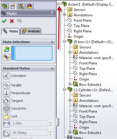

Click on the + symbol at end of arrow shown to expand the browser and then as you put your mouse over hidden planes in the browser they highlight in the graphics window so you know which one to pick.
For your second question you might simply need to flip the mate solution (mate or flush) aligned or anti-aligned.
