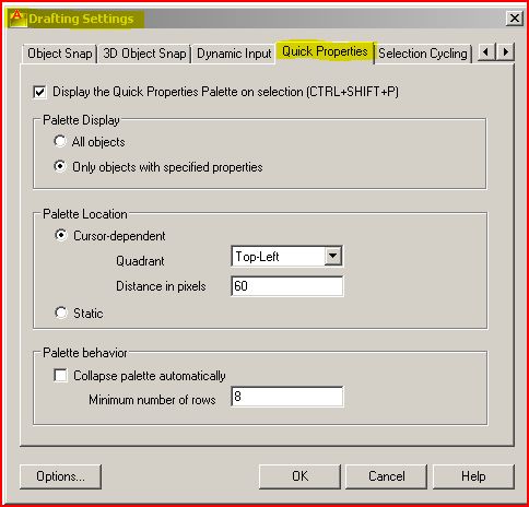

Yet another way to go, for those who might find it distracting at times, is to make the palette transparent, unless moused over, although I am having trouble finding that option at the moment. AH, got it, see the second attachment.

Yet another way to go, for those who might find it dstracting at times, is to make the palette transparent, unless moused over, although I am having trouble finding that option at the moment. AH, got it, see the second attachment.
