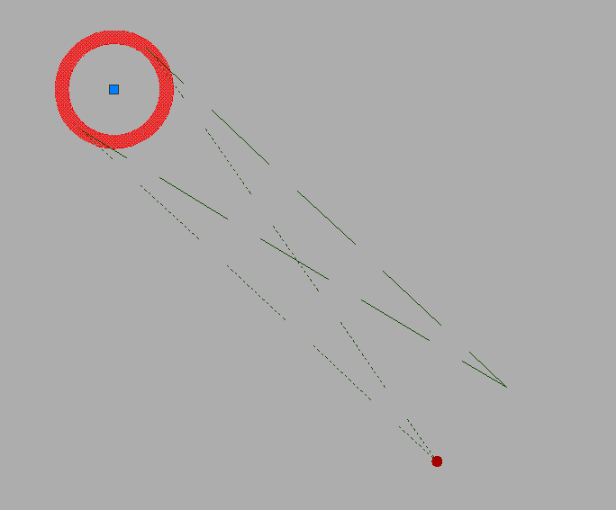

I have a block of a circle and a line coming from the left and right side quadrant of the circle to a common point (see pic). I want to create a dynamic block using a Stretch and Rotate parameter. You select the block, the Rotate point (grip) shows at the end of the two lines. I can grab that grip and rotate both lines and circle by moving this point around the screen, but cannot Stretch this point to a new location at the same time.
How can I have the Rotation end point follow the Stretch parameter?

Try the polar parameter with the polar stretch action. Ensure that the first point of the polar apramter is in the center of the circle and the second on the end point of your lines.
Thanks Mike,
Your suggestion worked like a champ!
