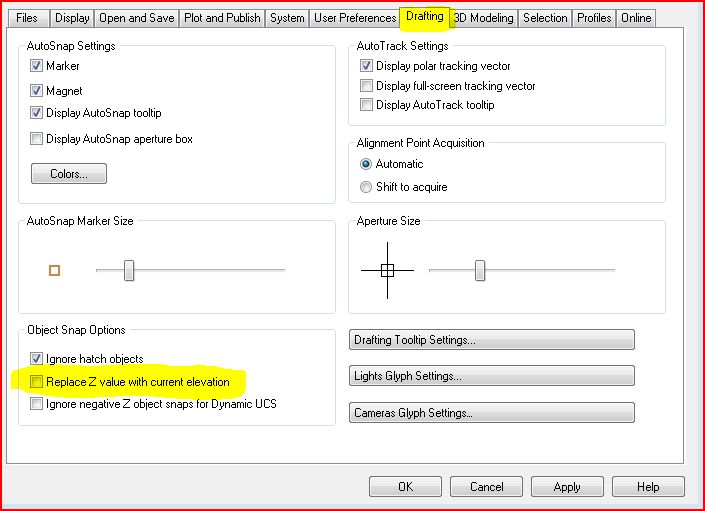

If alanjt's solution doesn't do it for you, then try this option on the drafting tab of your OPTIONS.
Same effect. All three deal with the OSNAPZ system variable.
