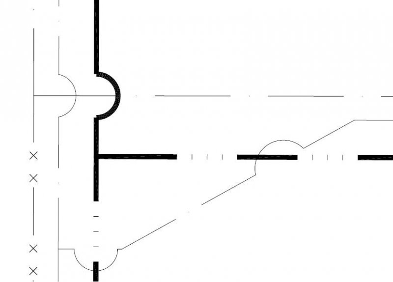

suriwaits Posted May 1, 2013 Posted May 1, 2013 Hi, I am looking for pipe hop lisp as follows 1. Select 1st line (Polyline, line) 2. Select 2nd line to create hop. 3. Ask for diamter of circle 3. draw semi circle in same layer as second line, taking centre of semi circle as intersection point of 1st and 2nd line 4. trim the 2nd line inbetween the semicricle. Thanks in advance Suriwaits Quote
suriwaits Posted May 1, 2013 Author Posted May 1, 2013 I am looking for lisp to draw something like attached Quote

suriwaits Posted May 1, 2013 Author Posted May 1, 2013 I have found similar http://forums.augi.com/showthread.php?139377-Need-Jumpover-Lisp-for-Electrical-Drawings but it is not working with polyline. Also it don't have option of layers. It would be great if someone could alter this for me Quote

suriwaits Posted May 1, 2013 Author Posted May 1, 2013 Thanks Alanjit, stevesfr & Lee. This one works fine for me. http://www.cadtutor.net/forum/showth...ghlight=jumper Break Symbol by CAB, looks awesome, i will use this for new drawings. it's a great help and much appreciated. Quote
