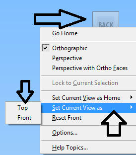

In the part file set the orientation of the part with what YOU want as the Top or Front view of the part.
Right click on the face of the View Cube and select as appropriate. (please report back as I haven't tried this and want to know if it works for the idw problem)
Hi thanks for the reply, I have already tried this but it does not work. The part will change but when it is put into the .idw it retains the original planes/ucs.
