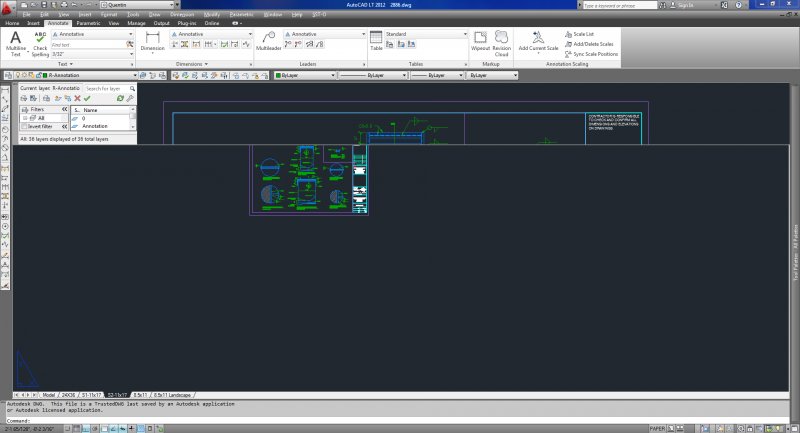

qball Posted May 2, 2013 Author Posted May 2, 2013 Can I remove just the SP? Or do I have to remove and re-install Autocad? 2 main glitches that annoy me: - When opening ACad I have Layer and Properties palettes docked on the left and Tool palette docked on the right. There's a weird break as seen in the attached image. I can collapse autocad or shut it down and restart and sometimes it's fine, sometimes it's back. A related problem (I think) is that sometimes the Properties palette won't load. I hit ctrl+1 and still nothing. Again, have to restart acad. - 2nd problem, moving or copying objects, it's like I'm hitting "from", I have to pick several points, sometimes up to 5 points before it finally decides to place the item. I'm not hitting "from" point. Quote
