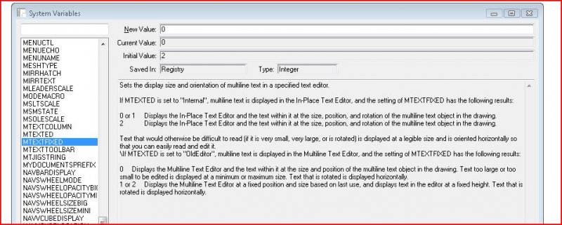

You should check your mtextfixed variable settings, as described in the image.
I checked all the settings of mtextfixed along with mtexted. The displays were different but the text was visible.
The problem still persists - the text vanishes as i enter text editor....
