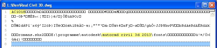

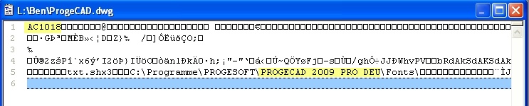

If you open the DWG file in question using a normal text editor (I used TextPad) you can see as the very first word on the first line in the file in which version of AutoCAd it last saved (here it was "AC1018" which is AutoCAD Civil 3D 2004 format). If you want to see the full list see this link: http://autodesk.blogs.com/between_the_lines/autocad-release-history.html
A few lines further down you can see which program saved the drawing originally.
Make sure 'Word Wrap' is turned off so that you only see the start of each line, as the lines are extremely long.

It means it was saved down to Release 14 format. The screen shots I posted in post #5 were saved from AutoCAD Civil 3D 2010, but showed as 'AC1018' - AutoCAD 2004 format.
