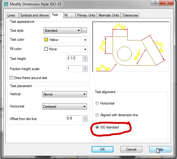

Maybe he believes that since this says "Standard" then he is dimensioning standard.

Good shout. Was the right Dimscale selected...?
