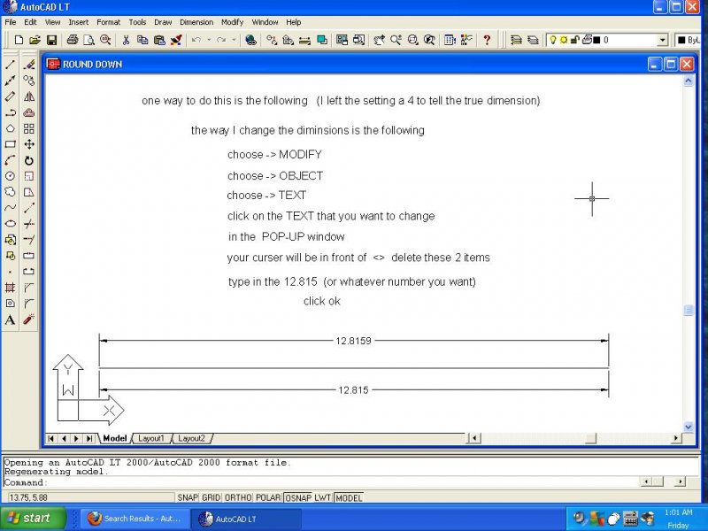

This may not be what you want but it can be done this way
You can change 1 dimension or 21 once the pop-up window is called up
after you change the 1st dimension just click on the next one to change it
when you are done press enter.
You can enter any dimension you want such as 23.75 - 23'-3/4" - 22-7/16" etc.

Well, of course it will "work", it just voids the actual dimension entirely. I use this technique myself when there is a break in the part and the actual dimension is incorrect anyway; or when I want to use the dimension form for something other than an actual dimension; or if I want to sabotage someone else's drawing so that they get in trouble for causing something to be fabricated to the wrong dimensions. The latter works especially well when they are editing the drawing via Stretch.
