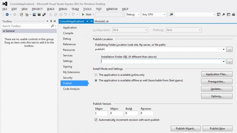

Tyke Posted May 10, 2013 Posted May 10, 2013 If you right click your application in the Solution Explorer panel and then Properties, it opens the properties tab. In the list on the left hand side click on the "Publish" item. You then see a drop down combo box labelled "Publishing Folder Location ..." and a browse button, where you can select the folder to where it should be published. Is that any use to you, as it's from VSE 2012, I don't have VSE 2010 installed here. Quote
dbroada Posted May 10, 2013 Author Posted May 10, 2013 I can only get a "Publish Folder" which is where the install files are published, not where the shortcut is created after the install (IYSWIM). I have looked through the manifest (which I didn't know existed) but there is nothing obvious there. Out of interest, how different is VSE 2012 likely to be from VSE 2010? There are rumours that my machine will be splatted soon and after that I will probably only download one vresion. Quote

dbroada Posted May 10, 2013 Author Posted May 10, 2013 Tyke, I don't get the "offline" option so it looks like I'm stuck with it for now (unless BB comes along with a new revelation ) and maybe I will get W7 64 bit soon. I assume (hope?) that any code written in VSE2010 will not be too painful being moved to VSE2012? Quote
Tyke Posted May 10, 2013 Posted May 10, 2013 Tyke, I don't get the "offline" option so it looks like I'm stuck with it for now (unless BB comes along with a new revelation ) and maybe I will get W7 64 bit soon. I assume (hope?) that any code written in VSE2010 will not be too painful being moved to VSE2012? Dave, I've copied the What's New info into a PDF file for you. If you download the VSE 2012 package and read the (very) small print it tells you the minimum requirements for running it. If you have VB 2010 code you can open that in VB 2012 and it is converted into the new format. Up to now I have had no problems whatsoever using VB 2010 Professional code in VSE 2012. But you cannot open a VB 2012 project in VB 2010, which is a bit restrictive for me as laptop, office PC and home PC all have different OSs and specs. So at the moment I'm sticking with VB 2010 to provide me with the flexibility that I need. Whats new in VSE 2012.pdf Quote
