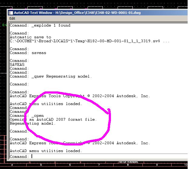

Is there any way to determine what version a file is?
There are several. I think the FAQ lists some of them but the easiest is to look on your F2 screen (when opening older versions)
ACADVER system variable is one way i know of.

Thanks, everyone. The F2 method works best for me.
