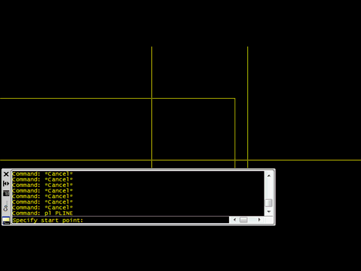

I do what i think your talking about in Vanilla autocad, with a pline and arcs using the direction option....
Ghostrider, thats the cleverest reply ive seen.
Thanks
p.s How did you do that?
:lol: Yea I like those little gif's picture explain better than words sometimes... there are a few programs out there that can record from your screen the one I use is called Camtasia studo. I learned about it here seeing a few posts with it in it, probably one of fuccoro's..
the Polyline is easy to "jump" the crossing lines, use the option for arc "a" then set the direction you want the arc with "d" to go back to a straight line hit "l"
