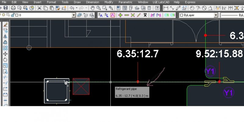

fathihvac Posted May 20, 2013 Posted May 20, 2013 Hello, The attached screen shot shows entities containing information different from usual. When i hover over any of these entities a tool-tip is displayed showing these information.How we can do this? means put extra data into entity object. Quote
MSasu Posted May 20, 2013 Posted May 20, 2013 I would guess that that isn't a regular entity of AutoCAD, but actually an entity specific to your vertical product (MEP). Quote
dortega4269 Posted May 20, 2013 Posted May 20, 2013 I agree with MSasu, I see this most often when coordinating with the MEP guys here at work. They use an add-on called TSI which provides them with entity information I get the prompts to a degree, but I am working in AutoCAD Architecture 2013... Quote
alanjt Posted May 20, 2013 Posted May 20, 2013 You have see if the custom entity registers in your CUI and customize the display from there. I don't have cad access ATM and it's been a while since I've goofed around in this particular display field, so that's the best I can offer. I'll be near cad tomorrow and will see what I can find then. Quote
troggarf Posted May 20, 2013 Posted May 20, 2013 Would installing the appropriate object enabler help display these object's properties? If not, these might help as well: Lee's Dynamic Info tool http://www.lee-mac.com/dinfo.html Andrea's tool that lets you read and edit xdata http://www.theswamp.org/index.php?topic=36098.msg412243#msg412243 Quote

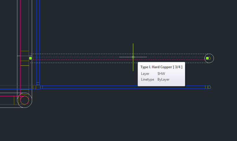

BlackBox Posted May 20, 2013 Posted May 20, 2013 (edited) troggarf, We're talking about vertical platform Objects... The options you provide are dependent on accessible XDATA... Vertical Objects are constructed over the AutoCAD, and Map 3D layers of the 'onion' so-to-speak (to use Civil 3D's AECC* Objects as an example)... (Generally speaking) The only way to access the exposed Properties is via External COM Interface Object, or .NET API. Besides, one of the best things Autodesk did in recent releases (to my mind) is the Quick Properties functionality, something most non-developers cannot fully appreciate... I cannot seem to find the post where I expressed my appreciation for the complexity of this in full, but to summarize, they (Autodesk) provide a pre-defined Editor.PointMonitor Event handler for each Typed Object given the applicable platform, one in which the user can configure via CUI Editor, which refreshes the settings for each, displaying the user-specified data, etc.. As a small demonstration of this complexity using only one entity Type (Raster), and a custom Tool Tip, see this post. Edited May 20, 2013 by BlackBox Quote
Dadgad Posted May 20, 2013 Posted May 20, 2013 troggarf, We're talking about vertical platform Objects... The options you provide are dependent on accessible XDATA... Vertical Objects are constructed over the AutoCAD, and Map 3D layers of the 'onion' so-to-speak (to use Civil 3D's AECC* Objects as an example)... (Generally speaking) The only way to access the exposed Properties is via External COM Interface Object, or .NET API. Besides, one of the best things Autodesk did in recent releases (to my mind) is the Quick Properties functionality, something most non-developers cannot fully appreciate... I cannot seem to find the post where I expressed my appreciation for the complexity of this in full, but to summarize, they (Autodesk) provide a pre-defined Editor.PointMonitor Event handler for each Typed Object given the applicable platform, one in which the user can configure via CUI Editor, which refreshes the settings for each, displaying the user-specified data, etc.. As a small demonstration of this complexity using only one entity Type (Raster), and a custom Tool Tip, see this post. That was in a post about the rollover tooltips, may have been described as the hover tooltips. I too really like the Quick Properties. If you go into your CUI and click on Rollover tooltips you will be taken to the menu which can be customized for diplay by entity type (like Quick Properties), but the screenshots shown are clearly MEP related tidbits Quote
troggarf Posted May 21, 2013 Posted May 21, 2013 So would my first suggestion display these properties? "Would installing the appropriate object enabler help display these object's properties?" troggarf, We're talking about vertical platform Objects... The options you provide are dependent on accessible XDATA... Vertical Objects are constructed over the AutoCAD, and Map 3D layers of the 'onion' so-to-speak (to use Civil 3D's AECC* Objects as an example)... (Generally speaking) The only way to access the exposed Properties is via External COM Interface Object, or .NET API. Besides, one of the best things Autodesk did in recent releases (to my mind) is the Quick Properties functionality, something most non-developers cannot fully appreciate... I cannot seem to find the post where I expressed my appreciation for the complexity of this in full, but to summarize, they (Autodesk) provide a pre-defined Editor.PointMonitor Event handler for each Typed Object given the applicable platform, one in which the user can configure via CUI Editor, which refreshes the settings for each, displaying the user-specified data, etc.. As a small demonstration of this complexity using only one entity Type (Raster), and a custom Tool Tip, see this post. Quote
BlackBox Posted May 21, 2013 Posted May 21, 2013 So would my first suggestion display these properties?"Would installing the appropriate object enabler help display these object's properties?" Quite possibly, depending on the vertical... For example, Civil 3D comes with AMEP Object Enablers built-into the installation OOTB, whereas AMEP requires one to manually install the Civil 3D Object Enabler after-the-fact. Re-reading the OP, it sounds as though the OP is using AMEP, but has previously had this/these setting(s) disabled. *not sure* Quote
