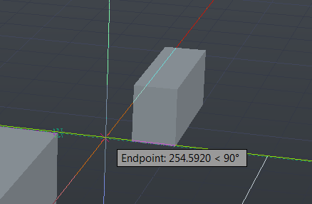

I have tried and yes you can, you can also use FROM (@X,Y,Z)is better :)
I hope you can see the green dashed line.
