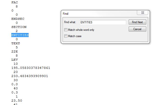

On that version you should either (1) save the files in DXF format, open the file, look for ENTITIES section and get the coordinated from there or (2) use an AutoLISP routine.
Hi MSasu- Thanks for the quick reply. I have been able to create the .DXF file but can find no reference to ENTITIES. Where might I find this in AutoCad2000?
Kind regards
Open the DXF file in a text editor, and do a search for ENTITIES.

Hi - Following up on the thread above I have now been able to save my Autocad drawing in .DXF format and have now opened it in Notepad to find the string "ENTITIES" from which I was able to recognise some dimensional data associated with the drawing. Can anyone iexplain in simplfied terms the next step in creating a CAM control file i.e. how to separate out the relevant dimensional data from the mass of information available in the file. Ideally I would like to be able to limit the data to be extracted to that contained on one particular level e.g. that level in which I have put all the relevant dimensional data. Can data associated with specific levels be indentified in the .DXF file? Apologies if the questions might appear to be somewhat naive. Kind regards
Perhaps when you create the DXF file, you could use the option of Entities Only. That way, you could select the entities that you are interested in, and leave out the rest of the abundant data.
