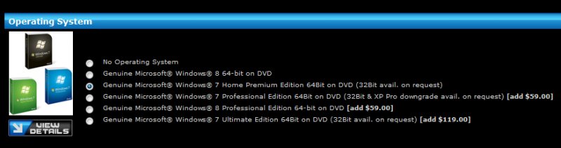

ReMark Posted May 28, 2013 Posted May 28, 2013 I think some manufacturers will let you choose which OS you want loaded. For example, Xi Computers offers the following choices for their Xi PowerGo XT Configuration. Quote
