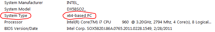

You can also use Windows own "run" function and type msinfo32.exe. At the screen that comes up next you can tell at a glance if your system is 32-bit or 64-bit.

O.K. Thank you very much to all. It is great.
