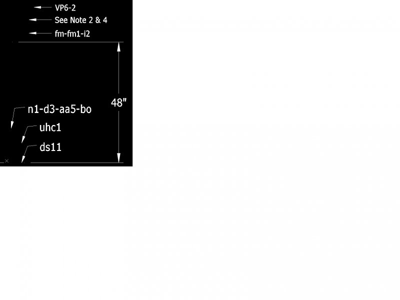

I am working on a drawing where the annotation scale was 1:30 and I changed it to 1:40 and all my annotative leaders no longer line up horizontally (the little line just before the text....see attached example).
Is there a way of globally fixing this issue without having to fix each one independently? This is driving my nuts! Thanks in advance.....:?
MLEADERALIGN command I think is what you seek.
