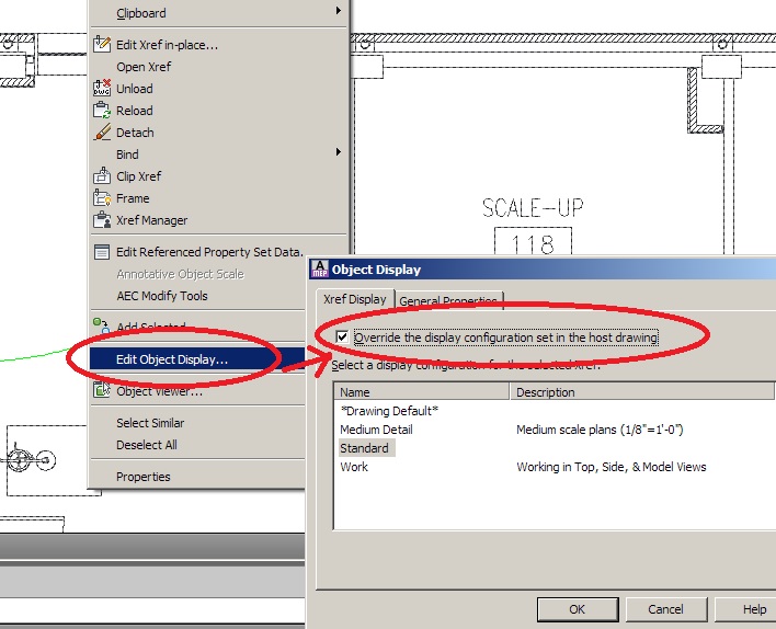

Jessica28 Posted May 31, 2013 Posted May 31, 2013 I have 3d windows and walls in my xref drawing. I wanted everything grey so I went into my display manager and made everything grey. I then took this file and xrefed it into a working drawing...Now what is happening is that the windows in the working drawing keep changing colors to whatever layer color is current. I checked my display manager in the working drawing as well....Any ideas what is making this happen? Quote

RobDraw Posted June 3, 2013 Posted June 3, 2013 Objects in the XREF file that are on layer "0" and color set to "ByLayer" will take on the color of the layer that the XREF is on. Quote
Jessica28 Posted June 3, 2013 Author Posted June 3, 2013 Yes. But what is happening Is the window (which exists in the xref) changes color to whatever the current layer color is...The xref is on its own layer and stays on its own layer...I'll go to my "laymcur" command and select a fire alarm device lets say. The fire alarm device lives in the current drawing. not the xref. the fire alarm device layer is red...When I make that device my current layer the window turns red.... Quote

Jessica28 Posted June 3, 2013 Author Posted June 3, 2013 I was having a little trouble uploading files..they are under a meg but maybe still to big? either way, heres a link to a dropbox account folder that they live in...If you change the layer your on in the drawing that has the xref inserted you should see the windows change color....You just have to do a regenall to see it happen... https://www.dropbox.com/sh/g9x12099oggzbfz/2qLh0tAsgE Quote
nestly Posted June 3, 2013 Posted June 3, 2013 (edited) Very strange. Obviously, it shouldn't be doing that, but as a possible work-a-round, try right-clicking on the xref and override the display of the host drawing. Seems to work for preventing the color change, but I didn't experiment to see what affect it has on the different display styles Edited June 3, 2013 by nestly Quote
Jessica28 Posted June 3, 2013 Author Posted June 3, 2013 Yes, that does seem to work. But I also worry about what you said. How it will affect other stuff....Right off the bat I saw wall hatches pop back on Quote

nestly Posted June 3, 2013 Posted June 3, 2013 ....Right off the bat I saw wall hatches pop back on OK, so we'll scratch that one off the list. I opened the drawing in AutoCAD 2013 and 2014 (not MEP) and the same happens, although the ACA/MEP Object Enablers are loaded. It does NOT occur in AutoCAD 2011-12, but I can't say if that's because of the version, or the lack of OE's. Merely changing the current layer should not change the display of existing objects, so I can't see this as anything other than a bug. Are you on Subscription, or have you sent a feedback report to Autodesk about this problem? AutoCAD MEP can be confusing for a lot of people .... Yeah, tell me about it. I really "should" be using MEP, but I haven't got enough time to learn it, and the prospect of trying to convert all my existing equipment into MVParts and all my fitting into (whatever MEP pipe fittings are) .... overwhelming. Quote
