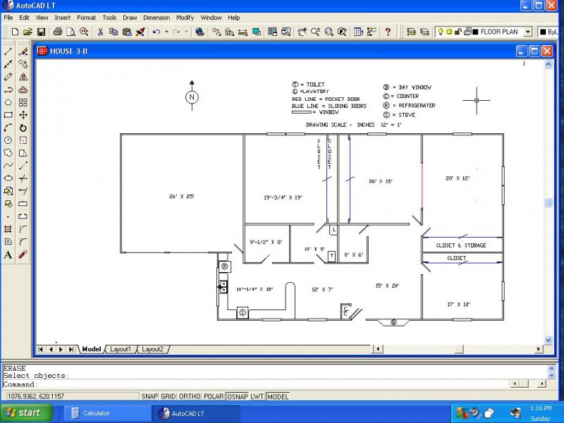

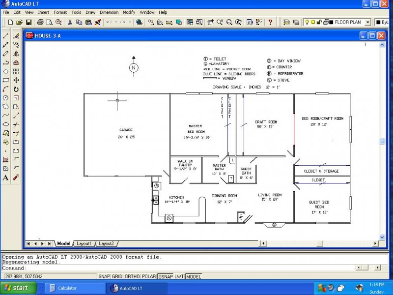

Sorry i did not make it clear what i meant -- take a look at the 2 screen shots
one is the original house-3-a the other is the original saved as house-3-b
in house-3-b i have erase the room names and the original still has them
hope the helps
