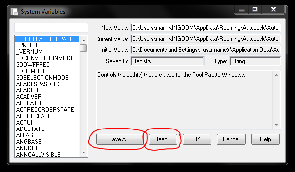

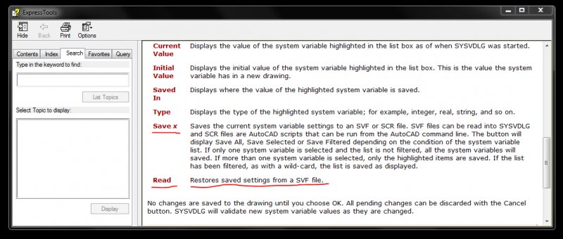

Express Tools, SYSVLDG has a Save All and Read button to do this.
so thanxxxxxxxxx Mr rkent :):):)
