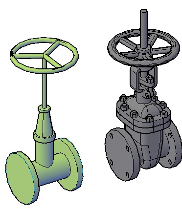

OK, I'm with you up to here on the display configurations, but it seems to only apply to the level of detail shown in 2D. I'd like to know how to have 2 or more representations of a 3D object. Below left is the default MEP gate valve, and a dimensionally correct gate valve. I wouldn't need to see that level of detail all the time, not to mention the impact on performance, but I'd need to be able to turn on the high detail 3D when needed.
I want to say I remember a way to have a low res and high res View... but maybe I'm just thinking of Revit. Either way, this is a decision you'll personally have to make. Try using the higher detail valve and see how performance goes. If it's still ticking along good, then you're all set.
