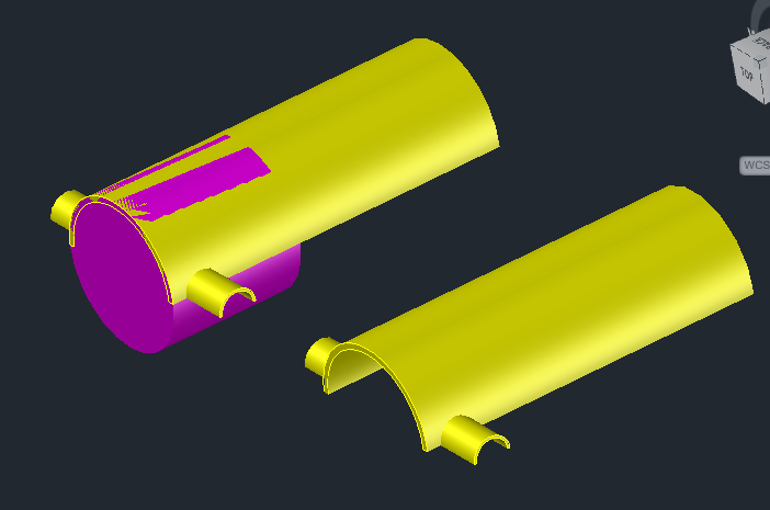

byk3bep Posted June 11, 2013 Posted June 11, 2013 I am trying to "trim" a curved object against another curved objects surface. The attached picture. Wanna get rid of the piece of the smaller arc that is under the bigger one. And another q: Should I be using surfaces or solids for this model? (and why) Thx a lot for your help and time Quote
ReMark Posted June 11, 2013 Posted June 11, 2013 Option 1: You can trim that piece away using an arc that is extruded in the form of a surface. Command: SLICE. Option: SURFACE. Option 2: Make a copy of the larger object. Subtract the original large object from the smaller one. You'll be left with what appears to be three separate objects but in fact they are still one entity. Use the SEPARATE command to break them up. Erase the middle object. Move the duplicate larger object back into its original position. Solid or surface? Depends on what you are drawing. Quote
byk3bep Posted June 11, 2013 Author Posted June 11, 2013 Ahm... That is what I am having trouble with. Don't know how to get the necessary surface for the slice The 2 objects are created buy extruding their cross sections. Solids. There are no surfaces to select when prompted for the cutting plane/surface... I am new, probably the most obvious answer is what I'm looking for. Quote

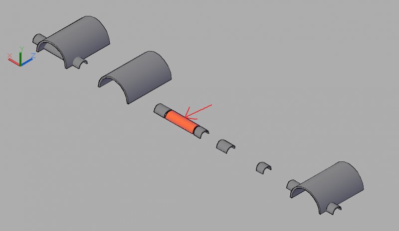

ReMark Posted June 11, 2013 Posted June 11, 2013 Option two kind of looks like this. After using the SEPARATE command you can erase the reddish colored section of the smaller object. Quote
ReMark Posted June 11, 2013 Posted June 11, 2013 Slicing with a surface. The red arrow points to the surface created by extruding an arc. Quote

byk3bep Posted June 11, 2013 Author Posted June 11, 2013 THX for all your help I decided to go with interfere=>separate combination, since i couldn't figure the other ones out but it wont stop me from trying. Quote
