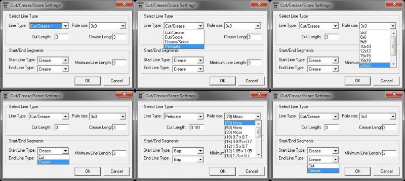

Dahzee Posted June 11, 2013 Posted June 11, 2013 I am presently using another CAD program which can create Lines and Arcs with two layers in them and can have variable lengths of segments and start and end with either of the two layers. Is this something that could be created with Autocad or Bricscad as I am looking to change my software for a newer program and need this kind of functionality. The two attached files show entities as created and exploded, when they are created they are on a layer called combination and when exploded they become the layer cut and crease. When exported to dxf and interrogated they seem to be anonymous blocks, I don't know if this will give anybody a clue. Plot2.DXF Apologies if this is in the wrong section, please feel free to move it. Any help gratefully received. Cheers Dahzee Plot.DXF Quote

Dahzee Posted June 12, 2013 Author Posted June 12, 2013 Neophoible, Thanks for the quick reply, I understand this is not normal AutoCAD/Bricscad functionality, the CAD software I am using is no longer supported, so I was wondering if it can be achieved in a different way. The reason I need this functionality is to do with cardboard packaging, where you have lines and arcs which are composed of folds and cuts. A typical example is a perforation, when you need to tear a pack open. These come in many different pitches with varying gaps and cuts, which can start with a cut and end with a gap or vice versa. The drawings I create are used at 100% scale to run a CNC machine that cuts the cardboard and recognises what needs to be cut and what needs to be creased dependent on the layer. The lines/arcs therefore have to represent exactly when a line needs to start with a cut then a crease or start with a gap and then a cut in the case of a perforation. I have attached screen grabs of the dialog box that creates them at present. This is driven by text files for each different type of combination i.e. one for perforations, one for cut creases etc. I have also attached a pdf which shows the type of rules that are used to create the final tooling from my original drawing. Rule Types.pdf Hopefully this will make things a bit clearer. Many Thanks, Dahzee Quote

Dahzee Posted June 12, 2013 Author Posted June 12, 2013 ReMark, Yes, there are existing programs out there, but they are very expensive due to the small marketplace and have way more features than I need. It is a bit like having a garage with a sports car for fast driving, a pick up for carrying stuff, a people carrier when doing the school run and an SUV when you park in a field. You don't need them all just because you like driving fast or have children. There aren't any add ons for Autocad with this capability (that I know of) and I don't need step and repeat or 3D proofing. The software I am presently using was just a simple 2D program that the authors wrote this routine for and some others to allow you to create packaging. Mostly I only draw in 2D and use parametrics for many of the standard carton shapes, it's just that being able to create these combination lines is an everyday occurence that would take ages if I was to break the lines and change the layers, especially if it was a line 250mm long that needed to be broken into 2mm segments, that's over eighty 2mm lines, which I would have to change half of! I don't know if it is something similar, but I remember on this forum someone was looking to do zig zag lines, which weren't created from a linetype, and there were some interesting results I seem to recall. Again thanks in advance for your responses. Dahzee Quote

Dahzee Posted June 14, 2013 Author Posted June 14, 2013 LibertyOne, Thanks for your interest in this thread. Yes, the information passed to the machine is in a layer format as you can see in the exploded dxf file in my original post. The machine is a flatbed cutter plotter with a multiple tool head which can cut, crease and plot from one file sent to it. Regards, Dahzee Quote
