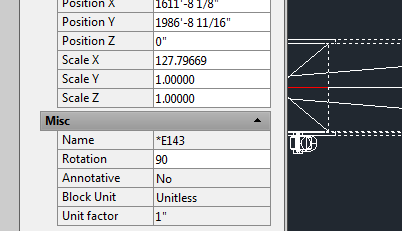

I have a 3D model and I'm trying to explode some of the entities so I can convert the objects to 3D Solids so transitioning into Revit is smoother. I have a lot of blocks where the name begins with an asterisk and I cannot remember how to overcome this pesky downfall. Any ideas? I've searched some previous threads but am coming up empty. It just says "cannot explode block" and I figure there's a quick way to do it. I tried the BLOCK command to redefine the block, enabling the checkbox to explode but AutoCAD thinks there isn't a block. Thanks in advance!

Funny. Can't find E143 in a list of blocks even after isolating and identifying the block itself via Quick Properties. Can't rename something that isn't listed.
*E### = anonymous non-uniformly scaled blocks.
