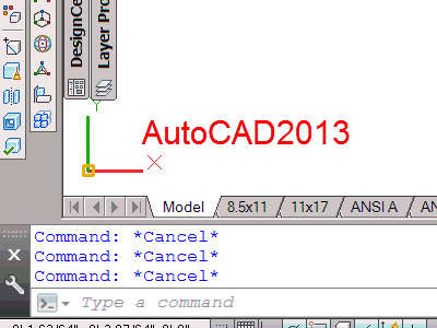

nestly Posted June 21, 2013 Posted June 21, 2013 I'm using the same acaddoc.lisp in everything, so I don't think it's a lisp in my case, other than that, MEP is basically using the default settings. Here's an animation to that shows the different behavior Quote
nestly Posted June 21, 2013 Posted June 21, 2013 (edited) On my system, changing NOMUTT in vanilla AutoCAD had no affect on whether the answer was displayed on the command line, but in MEP, it does. *Edit* After restarting, MEP behaves the same as Vanilla, including NOMUTT, so I agree that it's a probably a "built in" lisp in the verticals. Edited June 21, 2013 by nestly Quote
