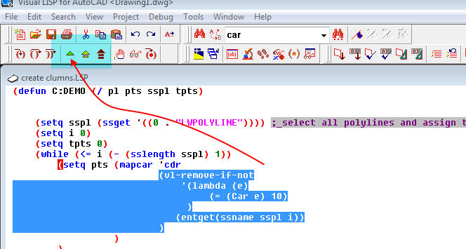

Hi
when i set breakpoint and the intepeter meets lamda i get a new window :
;;; Copied to window at 4:56 PM 6/21/13
(LAMBDA (E) (= (CAR E) 10))
;;; End of text
and i cant go on with my test
why its like that and how to overcome?
Thanks
Shay

So the problem is that when setting breakpoints , I followafter each statement but when the interpreter get to lambda a new window appearand im stuck, the sassion stops.
That why I asked how the code can help me because I didn’t seethere anything relevant to my problem

My apologies for the confusion on my part... I understand you're attempting to understand what's going on with Lambda, and my code was intended to demonstrate that the Lambda in your code is unnecessary to begin with.
However, you're correct, even if my code does what you're after, it does not answer the question of why you're experiencing the behavior regarding Lambda in VLIDE.
... the question of why you're experiencing the behavior regarding Lambda in VLIDE.
I suspect this is due Lambda being an anonymous function.
I already use alternative becuse of the debugging berrier, but I can see how much of code one lambda is saving you. But can't afford coding without debugging
