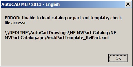

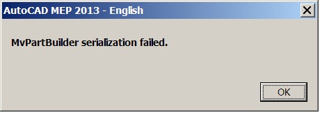

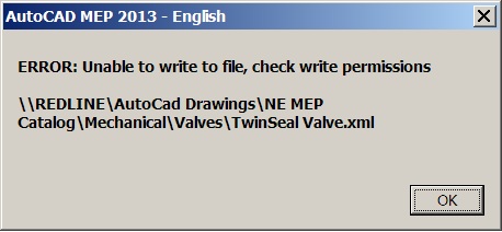

So I worked my way through the 18 pages in Chapter10 Creating a Block-Based Multi-View Part only to lose all the work to the following error messages when clicking "Finish".
After going through the whole process of building a Block Based MVPart several more times trying to create the MVPart in different catalogs, I finally discovered that "Shared Content Path" was not pointing to the OOTB default folder. Changing it back seemed to solve the above errors, but I don't understand what the "shared content path" does, or why it would cause MVPart creation to fail.
I also fooled around for hours just trying to make a new catalog for my custom parts. Catalog editor would make the folders, but would not create the .apc file. I finally got it to work by copying a random .apc into the folder I specified for my custom catalog, adding the necessary chapters, renaming, and then deleting the source files. Surely that's not how new catalogs are supposed to be created.
Now I'm trying to figure out how to get back into MVParts to edit them (ie adjust connectors or edit the 2D representations). I know I can get into the dwg files in the catalogs to edit the blocks, but how do you get back "insided" the MVPart?

Shared content path allows a cad manager to point everyone to the same catalogs instead of individuals all pointing to their individual machines. If everyone shares the same catalog the cad manager can create a part once and place it in the catalog and then everyone will have access immediately. You are probably getting the errors you received because the shared content path is pointing to a network location that you do not have write access to. This is S.O.P. in most companies.

I still don't understand why I couldn't create a new catalog in a shared network folder, but if I have to make them locally and then move them to the network location, that's not totally intolerable.
...now moving on to Parametric parts... to be continued
Try mapping to a Networked Drive instead of the \\REDLINE\ networked directory.
