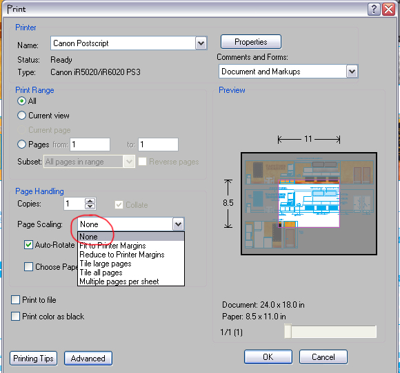

BenE Posted November 19, 2008 Posted November 19, 2008 Whenever I plot to .PDF, the drawings don't come out to scale. I thought it might be the plot margins within Adobe, but I haven't been able to figure out how to correct this. Any ideas? Quote

Guest Posted November 20, 2008 Posted November 20, 2008 Okay this is what I think that it is. You print to file, then you open up the file as a pdf file, then print. This file that you print is not to scale. I am assuming that this is where you are having problems. I do not believe that it’s Auto CAD that is the problem, but your PDF print settings that may be your problem. You need to have the proper paper size selected from your printer before you can do it this way. (If the drawing was originally 8 1/2" x 11" you need to have it selected) Next all that you need to do is set the printer margins to 'none' as in my example. If you select 'fit to printer margins', your drawing will not print to scale. Quote

BenE Posted November 21, 2008 Author Posted November 21, 2008 Hey, guys. Thanks for all the responses, and sorry for my late response. I'm a student and only work half-time. Nocturne00: I use extents as my plot area. Using the hand held scale and a print of the PDF, it appears to be scaling down 5%. Secretagdan: You are correct that I am plotting to PDF, and the print is scaled. I am using Paper Size 11x17 (for an 11x17 paperspace and plot), and scaling is off. Wannabe: It's all set to 11x17. Thanks again, everyone. I'm going to give CutePDF a try and I'll post my findings. -b Quote
BOB'27T Posted November 21, 2008 Posted November 21, 2008 I would suggest selecting layout instead of extents. Extents will resize the drawing to fit, which is going to be inaccurate. Quote
BenE Posted November 21, 2008 Author Posted November 21, 2008 And we have our winner!! Looks like there's no need for the new PDF writer. Just another rookie error. Thanks a lot. -b Quote
