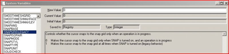

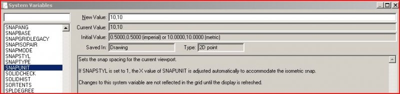

Dadgad Posted June 24, 2013 Posted June 24, 2013 Very annoying, for sure. I am putting up a hail mary here, see the image, and you will also see some other snap related system variables which may be causing your problem. Are you working in METRIC or IMPERIAL units? Have you tried rebooting the software? Have you tried auditing the drawing? Is this happening in a single drawing, or in any drawing you open? If it is in a single drawing, can you post it, or a part of it, stripped of any proprietary content? Can you do a screeshot of what is happening? Quote
Trickworm Posted June 24, 2013 Author Posted June 24, 2013 I am not using metric..I have closed the program and reopened it..if that is what you mean by rebooting software. I have not tried auditing the drawing. I do not know how to do this. I have opened up other drawing to check this, and it is happening in all that I have opened. How would I do a screen shot of what is happening? How can I check my system variables to see if they are 1 or 0 on SNAPGRIDLEGACY? Quote
Dadgad Posted June 24, 2013 Posted June 24, 2013 I am not using metric..I have closed the program and reopened it..if that is what you mean by rebooting software. I have not tried auditing the drawing. I do not know how to do this. I have opened up other drawing to check this, and it is happening in all that I have opened. How would I do a screen shot of what is happening? How can I check my system variables to see if they are 1 or 0 on SNAPGRIDLEGACY? By rebooting I meant closing and restarting the software, so we can check that one off the list. You can AUDIT a drawing by using the AUDIT command, but based on what you say about it seems to be a problem on any file you open, that likely would not help with this particular issue. In order to determine your current setting for a system variable, you just need to enter the system variable name at the command line and hit enter. The response at the command line will look like this , and the number shown is the current setting of that system variable. In order to change the setting one would enter the new desired value and hit ENTER. Quote

Dadgad Posted June 24, 2013 Posted June 24, 2013 The list shown in my screenshots is accessed in newer versions by SYSVDLG command, which stands for system variables dialog. Sadly I do not believe you have access to that command in the 2008 version. The list entitled SYSTEM VARIABLES in the images gives the variable names, such as SNAPUNIT, or SNAPGRIDLEGACY. By entering such a variable name at the commandline, the response will indicate the current system variable value, and you will be given the option to change that setting by entering a new RECOGNIZED and viable system variable value. Quote
