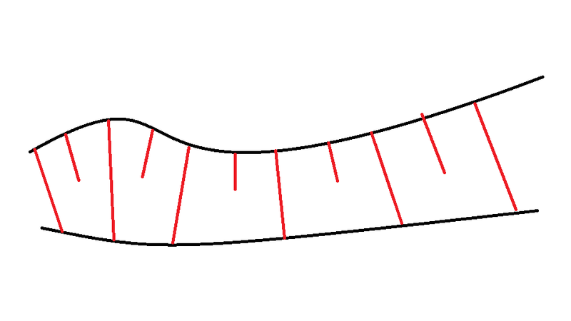

I am trying to writing a small lisp to do following thing between two polylines:
It must:
select first polyline
divide it in n parts -> get computed points.
From each point, draw a segments perpendicular to the first polyline that stops at the second polyline.
Every two segments, break the drawn segment in two parts and delete one part.
I don't know how to start writing my lisp :unsure:
Thank you a lot. :)
