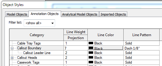

Manage Tab > Object Styles. Go to Annotation Objects and edit the Callout Boundary line pattern... there's a sub-cat for the Leader Line too.
thank you very much kind sir
