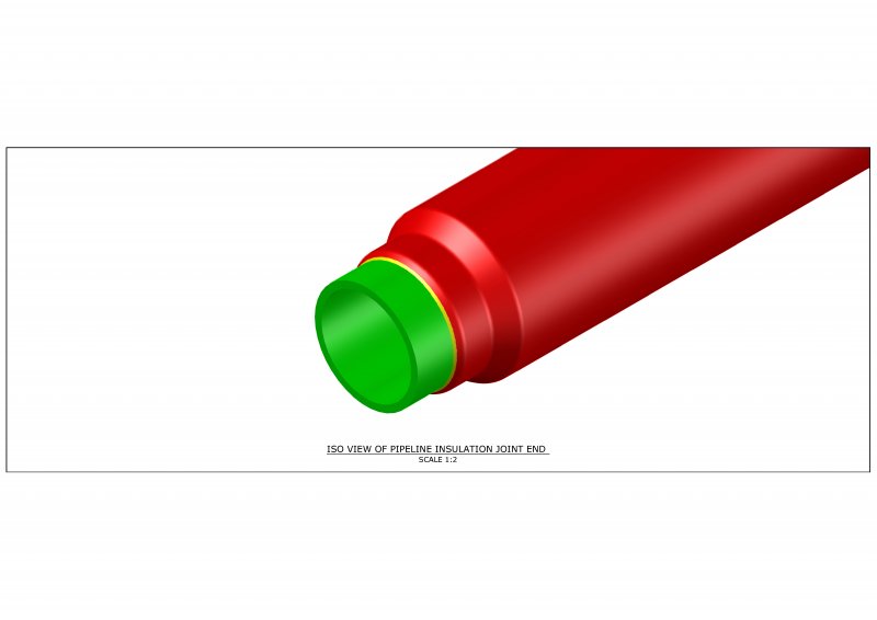

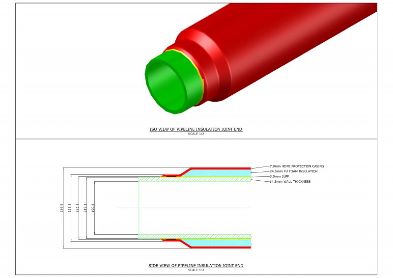

Arokain Posted July 1, 2013 Posted July 1, 2013 Hi everyone I am new here and I have a small problem that I hope you can help with. I have tried many of the sort of solutions I can find in threads here but none seem to do what I want. ie facetres = 10, viewres = 20000, isolines = 2047 etc. Below is a PDF'ed image of the problem As you can see the pipe end is very jagged, just the viewport of the pipe comes out acceptable see below Now if only I could plot the second one in the first i'd be happy. Any suggestions ? Regards Quote

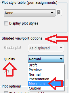

JD Mather Posted July 2, 2013 Posted July 2, 2013 I am currently playing with the plotter config ... Try this one If that doesn't work, can you attach example file here? Quote
Arokain Posted July 2, 2013 Author Posted July 2, 2013 I tried that one already JD, no joy there either. I even upped the DPI to 1200 and that didn't work. Hummm I cant get the upload to work, It just hangs when trying to upload the dwg file Quote
