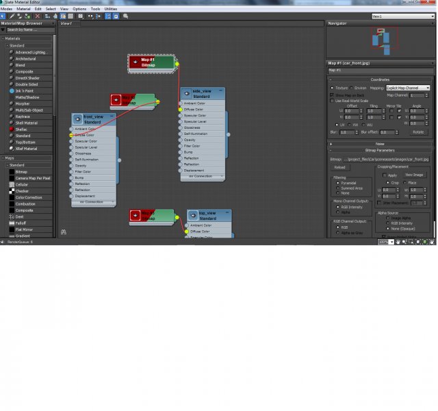

I'm not getting any of my materials or images preview in the material editor, only a picture of a lamp or something.
Can you provide a larger image, showing your entire material editor, so I can see what you have set up?
Sorry but I don't know what's causing this. I've never seen that happen before and I can't replicate it on my copy of 2011.
Did it just start happening all of a sudden?
Does it happen in all files or just that one you're currently working on?
Is this problem isolated to just the slate editor or does it also happen in compact mode? And does the bitmap texture show up in the viewport when you apply it to the model?
You could try running a repair. Maybe something got corrupted within your installation.
On the bottom left there's a little teapot - that toggles your material editor rendering on/off. That stumped me first time I accidently hit it :)
The little teapot fixed the problem.
