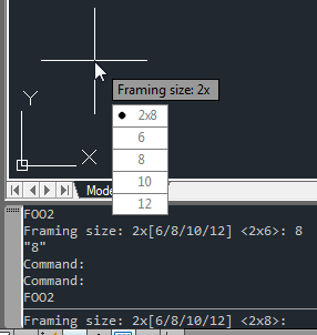

Also, beware of:
The only way 2xtxt will not be one of the allowed values is if the user manually uses LISP to change it, so I'd be comfortable with not checking for Member. Were that necessary, and I did not need the resultant list elements from Member, I'd employ vl-Position for expediency.
Also, beware of:
[ATTACH=CONFIG]42761[/ATTACH] [ATTACH=CONFIG]42762[/ATTACH]
