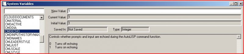

A parting shot from an illisperate, who occasionally gets lucky with variables.
Glad to hear that you had an .svf to restore your settings, and that may have precluded this shot in the dark. There just don't seem to be very many published
system variables dealing with such issues. :)

But here's a guy having just the opposite issue. Perhaps setting the variables listed to "0" will help you as well.
