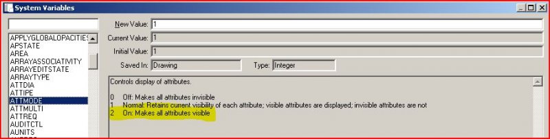

Dadgad Posted July 5, 2013 Posted July 5, 2013 Welcome to CADTutor. In my version of Autocad Vanilla 2013, the variable is ATTMODE, and you probably want to set it to 2, as shown in the image. Enter ATTMODE at the commandline, then when asked what you want to change it to, type 2, and hit ENTER. Quote

Tyke Posted July 5, 2013 Posted July 5, 2013 Welcome to CADTutor. In my version of Autocad Vanilla 2013, the variable is ATTMODE, and you probably want to set it to 2, as shown in the image. Enter ATTMODE at the commandline, then when asked what you want to change it to, type 2, and hit ENTER. Dadgad, doesn't that just control visibility of the attributes on screen? I'm not on my CAD computer at the moment but if I remember correctly even the hidden attributes show up in the properties palette, Sorry Carlos, welcome to the CADTutor forum. Quote

Dadgad Posted July 6, 2013 Posted July 6, 2013 Dadgad, doesn't that just control visibility of the attributes on screen? I'm not on my CAD computer at the moment but if I remember correctly even the hidden attributes show up in the properties palette, Sorry Carlos, welcome to the CADTutor forum. You are probably correct there, Tyke, I don't use Properties, I favor QUICK PROPERTIES, for the customizability. I was seduced by the mention of a system variable of which I had never heard ATTDISP, and when I looked into it, it seemed like a good fit. Too busy to follow through and check it out though. Quote

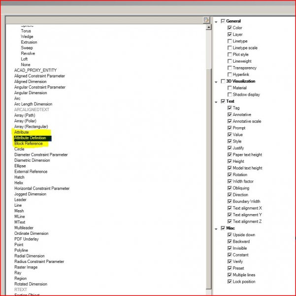

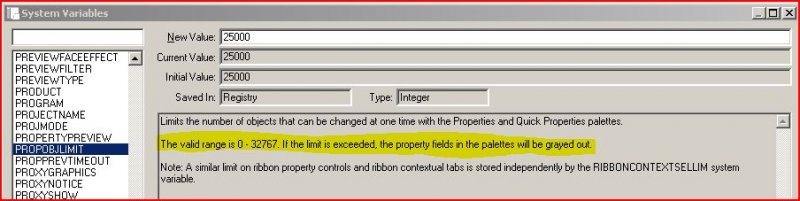

Dadgad Posted July 6, 2013 Posted July 6, 2013 I wouldn't really expect this to make any difference with the problem you are having, but it is probably still worth a couple of minutes of your time to check. Turn on your QUICK PROPERTIES, and go into the customize section by right clicking on the left hand border of the quick properties palette. As shown in the image, there are 3 entity types there which you should set to display the information you hope to see displayed on the QP palette. I read the AUGI link posted, and realize this is a snowball's chance in Hell, but what have you got to lose? When everything you have tried hasn't resolved an issue, you have to look for another approach. You don't have your PROPOBJLIMIT set to zero, do you? Quote
