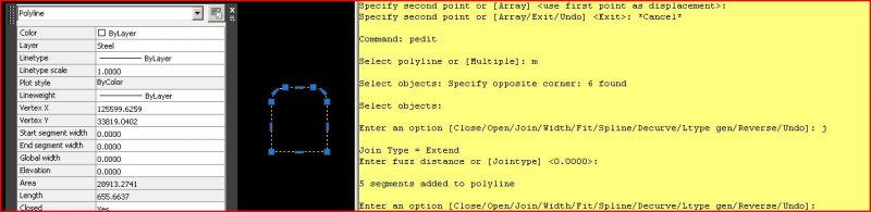

Dadgad Posted July 9, 2013 Posted July 9, 2013 You could try using the AREA command, after using PEDIT to JOIN them. Or once they are joined look in the properties box for the area. Use the MULTIPLE option in the PEDIT command, so that you don't need to select them individually. Use FUZZ DISTANCE of 0, and click enter at the end of the PEDIT JOIN command string. You might also want to use the CHANGE command, select PROPERTIES, ENTER, then ELEVATION, ENTER, choose new elevation of whatever you want, then hit ENTER twice. After you do that you may well be able to BOUNDARY, HATCH, or JOIN them. Quote
bumblebbabe Posted July 9, 2013 Author Posted July 9, 2013 I tried using the PEDIT command, and it linked all the lines together in the top right hand corner of my shape, but it wont work with my straight lines, so i cant link all the lines together to make one complete shape :S Quote

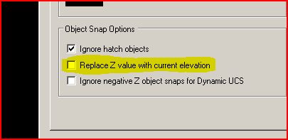

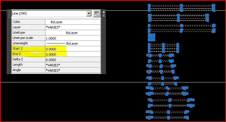

Dadgad Posted July 9, 2013 Posted July 9, 2013 could that have been because I was working off a survey plan?how can I fix my Z values for the future? I will have alot more shapes to calculate very shortly, so i just want to be able to identify the problem so I can fix it myself In the attached images you will see a couple things that will help you . One image shows the quick properties palette describing the lines shown on the screen. They all have the start and end Z values as 0, so we know that they are coplanar, and at elevation 0. You should probably go into OPTIONS, and on the DRAFTING tab set your OBJECT SNAP options to use the current Z value. In that way when you trace points they will generate a flat polyline. I see no reason why you wouldn't want to create a single CLOSED polyline when tracing these survey points. I do not do Civil or survey work, so there may be some strange reason, which I don't know. Quote
bumblebbabe Posted July 9, 2013 Author Posted July 9, 2013 Thank you so much for that! In my original document I went through the lines and changed their Z values to all be 0, so then when I tried to PEDIT them it all worked and they are all linked now and an area can be calculated! Thank you so much for your help with this problem! I have alot of areas to calculate and get cost estimates for, so knowing how to do this will be invaluable Thanks again Quote
