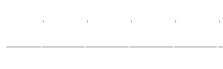

Proctor Posted July 9, 2013 Posted July 9, 2013 Hello: I need to create a line type that looks like this: _____|_____|_____|_____ I tried something like this to no avail: ;; MyCustom Linetype *My Custom Linetype,LINE LENGTH 1.70 WITH SPACE .05 havign a vertical line in space __ | __ A,1.70,.05,["|",STANDARD,S=.05,R=0,X=.05,Y=1] Thank you for your help, Proctor Quote
ReMark Posted July 9, 2013 Posted July 9, 2013 Is there supposed to be a gap on either side of the vertical line? Are you using a "pipe" as it is called on a keyboard to represent the vertical line? Quote

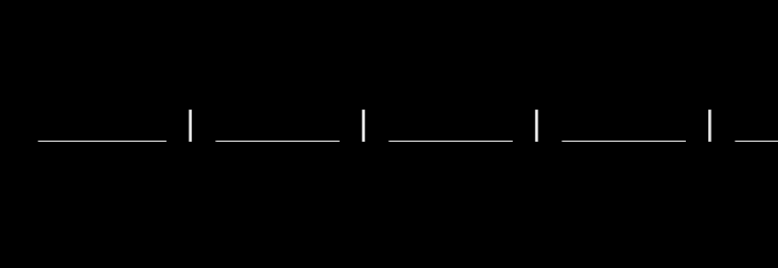

ReMark Posted July 9, 2013 Posted July 9, 2013 Well it isn't quite right but it's close. I used the "pipe" symbol off the keyboard. I think by doing so I'll have to tweak one of the settings in the linetype definition in order to center the pipe in the gap. Trial and error. Mostly error! Did you know that gaps require a negative value? BTW...I do not have a lot of experience creating custom linetypes so please forgive my crude attempt here. Thanks. Quote
Proctor Posted July 9, 2013 Author Posted July 9, 2013 Hi ReMark - thank you for replying. Yes, I was using the Pipe keystroke for those vertical lines. I added a negative in front of my .05 value to represent a space as you suggested. Here's a pic of what i'm now getting. The vertical lines are far up and not sure why? thanks again for your help...it's getting closer now. proctor Quote
ReMark Posted July 9, 2013 Posted July 9, 2013 Maybe you should change the value for Y to something less than 1? Quote
ReMark Posted July 10, 2013 Posted July 10, 2013 I like this one better. I am almost there but ever so slightly off with the centering of the pipe in the gap. But I wonder if anyone would even notice if I hadn't mentioned it? Quote

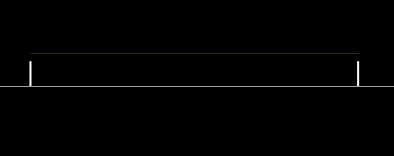

Proctor Posted July 10, 2013 Author Posted July 10, 2013 Hi Remark: I found out that the user doesn't need to have a space between the lines. They only need a line every 1.7 with a pipe in between. I am struggling with getting this correct. here's my code: ;; Linetype *MYLINETYPE,LINE LENGTH 1.70 WITH VERTICAL LINE DIVIDER __|__ A,1.7,["|",STANDARD,S=.25,R=0,X=0,Y=0],1.7 The problem with it (see attached), is that the line lengths are 1.9 for some reason as appose to 1.7. In addition, the vertical pipes are starting a tad to low. Thanks again for your help, Proctor Quote
ReMark Posted July 10, 2013 Posted July 10, 2013 I gave you a hint the last time regarding the pipes. You have to tweak the value of "Y". It isn't easy but trial and error will get you there eventually. I have no clue as to why the line lengths would be 1.9 and not 1.7 either way both those distances seem kind of long to me. What's the reasoning? Are these lines going to have a lot of bends or curves in them? Quote

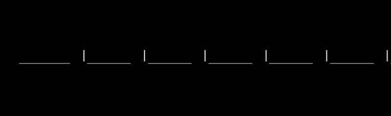

ReMark Posted July 10, 2013 Posted July 10, 2013 My last attempt. See that yellow line above the custom line with the pipes? It happens to be 1.7 units long. Quote

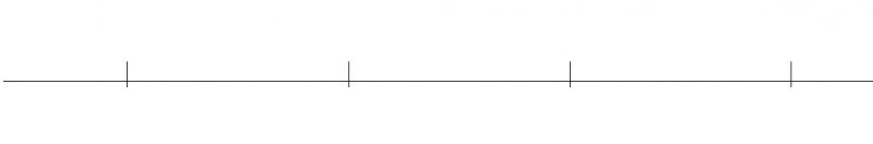

neophoible Posted July 10, 2013 Posted July 10, 2013 (edited) ;; Linetype*MYLINETYPE,LINE LENGTH 1.70 WITH VERTICAL LINE DIVIDER __|__ A,1.7,["|",STANDARD,S=.25,R=0,X=0,Y=0],1.7 I just tried your linetype definition and it came out perfectly in 2012, drawing in 2D. The pipe's btm endpoint is right on the line, and the 1.7 measures exactly, after I account for drawing scale (I also made sure the linetype scale is set to 1). Yeah, it looks like ReMark's picture. Well, except for the bold looking pipes. Is there a font associated with linetypes? Edited July 10, 2013 by neophoible Comparison with ReMark's image. Quote

ReMark Posted July 10, 2013 Posted July 10, 2013 The font is called out in the definition as STANDARD. The "S" is actually for the text scale factor. This can have two values either a "1" or a "0". If you want to learn more about custom linetypes and linetype definition files in general just do a search on "Ralph Grabowski"+"linetype". Find and read his three part article from his eBook "Tailoring AutoCAD". Quote
