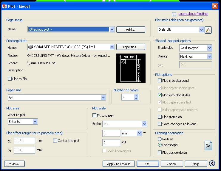

I am plotting this using an OKI C821 colour printer.
It prints with gaps between the black text/lines and the red and green sectors.
I want to eliminate the gaps.
I have tried increasing`VIEWRES' to 20,000 and segements in a Pline arc to 1000.
REV-A: Plot settings jpgs added.
Any help would be appreciated.
Thanks

What are your plot settings?
Morining. I can't see a proplem there. Can you upload your DWG and I'll take a look?

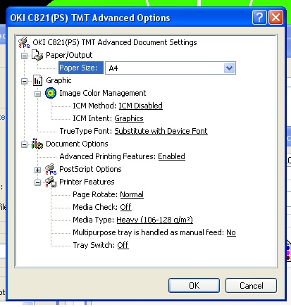

I altered the printer settings a few times until I got the desired result.
I changed the media type to "Medium" paper thickness, and we seem to be getting a positive result six out of ten prints, so that's one urgent problem off the list.
Thanks anyway.
You did not say but is that PDF the desired result? If so, make the printer settings match the PDF settings. I would start with the graphics and advanced graphics settings.
