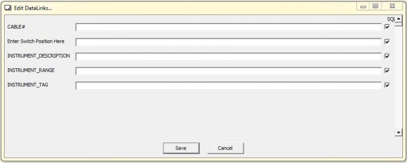

Maybe I am a bit cryptic the database software package isAveva Instrumentation. It has an addition to AutoCAD allowing the selection ofthe blocks to add data links into the attribute fields. These attributes getpopulated with the information from the Aveva database when the drawing isopened and the text of the attributes on the drawing gets updated as well. Block Table.JPGFor instancethe table for my block has the attributes: INSTRUMENT_DESCRIPTION,INSTRUMENT_RANGE, INSTRUMENT_TAG and CABLE# the text for these is changed fromthe data links with the text in the database and displayed on the drawing. Ihave added another attribute “SWPOS” where I can make a SQL query for the datalink to generate a value matching the visibility state for “Switch Type”.
I will need to trap the Modified event then check if themodified object is the “SWPOS” attribute of one of my blocks if so put thatvalue into the visibility parameter to make the switch picture change.
My problem is I don’t know to correctly call outthe path to access the correct properties.

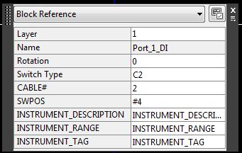

Thanks for the help. I have attached the block. I am thinking all I will need is to look for a change in the attribute “SWPOS” and then changing the visibility parameter “Switch Type” to that value. That way the changes of the other attributes will be done with the data links from the Aviva software. If I could put the data link in the “Switch Type” parameter Iwould just do that but that is not possible. :(

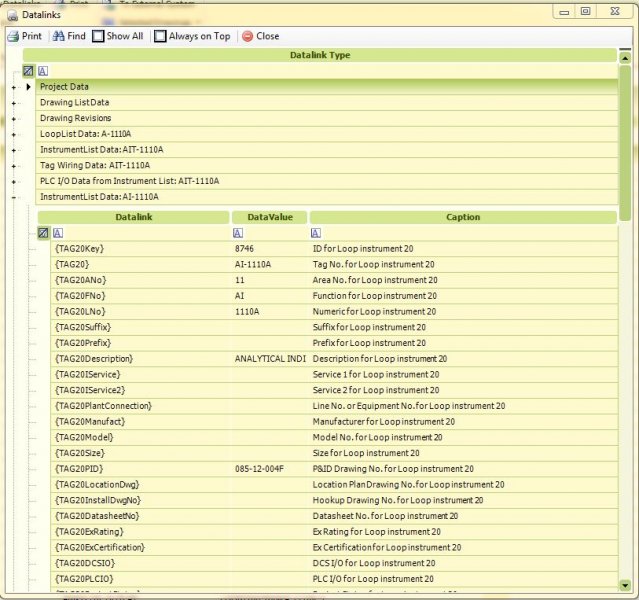

Thank you for your help but, I don't understand your question. The attributes are changed from the information the datalinks points to when the drawing is opened from the Aviva software. This is what the table of datalinks look like, you just drag and drop them into the form shown in my last post.Datalinks.jpg

That said, having glanced at the drawing you posted, I think I have my answer to the question of if a Command is used to modify the attribute value... Since your SWPOS attribute is being modified manually, instead of being modified by some programmatic means (i.e., .NET, ObjectARX, etc.), the EATTEDIT Command is used... We'll piggy-back that.
If, however, you instead change the SWPOS attribute value via Properties Palette, etc.. then the Command is _not_ used, and that ObjectOverrule I mentioned will in fact be necessary.
