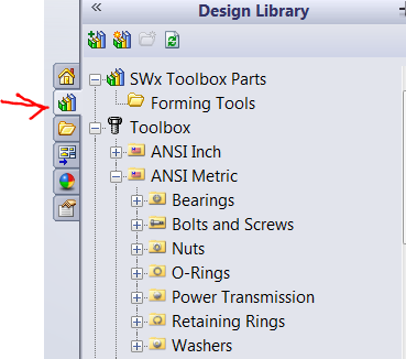

Check your Toolbox right side of screen.

I found that location, but still could not find the flanges.
I realize that there will be a transistion period.
I'm used to the INVENTOR Content Center Library, where I could either look through the listings on the left side of the screen, or use the search feature to find the object I needed.

JD,
I did not explore that location very well.
Now that I have, I have a new question ...
Where do you path the parts to, once you download them, and unzip them?
