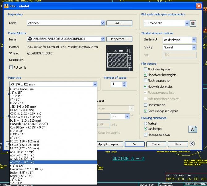

Plotter 26 has the following paper sizes available to it.
I want to use A3 but the two obvious syntaxes have been used (see code) without success. Can anybody suggest a way forwards?
