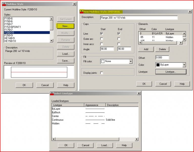

Al you should look into creating and saving MULTILINE styles to suit your needs.
They are very useful, comprised of multiple linetypes and colors,
self closing, or not, and justification can be set to your personal preference.
When you need to create one of these, you just define the path of the defining line,
and it contains all of the other lines, really quick and accurate.
If you enter MLST at the command line (you probably won't need to enter the whole
MLSTYLE), you should go to the dialog box shown in the image. Explore the CAPS and DISPLAY JOINTS options,
and consider which justification setting works best for a particular multiline style application. :)
