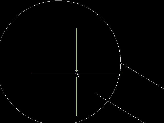

so here is the attachment,
Basically there are two graphs, first one is a circle connected with two lines.
Then I copied and deleted the circle, so there are two lines remind.
So you can just use the circle in first graph to create a new block and then try to insert block for second graph to make it looks like the first one . Which I dont know how to do it.....
Drawing3.dwg
I posted my attachment. Thanks for helping
what I did is insert the block, I choose one point on the circle to be my basepoint, then I connect the basepoint with the end point of one line.
So the circle connect with one line, but I have no clue how to connect to the second the line. Thanks for the tips Dana W told me, but it does not work for my case.....

Rotate > [R]eference
*edit* Incorrect image removed
Edited by nestly
I tried you way, but the question is, when I rotate the circle.(the circle connect with one line as you did) and then I click reference, I choose the end point of the line connected with the circle and the intersection point of the circle with other line. And then I click the end point of the other line to rotate the circle.
They are not perfectly math. which means the circle does not connect with the other line. I dont know why . am i doing wrong for some steps?
Perhaps another way of placing your circle is to first of all draw two temporary circles of the same radius ( 0.38 ) at the ends of the two lines. Then your circle centre point is where these two circles intersect. :D

OK, now that I see where the lines are, I like Eldon's solution. I could not open the drawing, so I was stuck with my assumption that the lines were on opposite sides of the circle.

Ooops.. you are correct, In my haste, I missed an important step.

I'd go with simple too, but just use the copy command, copy the circle using it's center point, 1st copy goes to the end of one line, 2nd copy goes to the end of the second line, and then 3rd copy goes at the point where the first two circle cross, then delete the 2 circles that are not needed.
Thank you so much guys, the way eldon and steven-g said are the same and its simple. also thank you nestly, I got how the reference command works.
