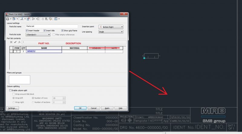

I have created a Pneumatic Schematic drawing using blocks for the variousparts with part refs attached, balloon refs and a corresponding parts list.
However, Our parts list normally follow the following format.
Item, Qty,Part No, Description.
The standard ACAD parts list does not contain a column for Part No's.
Any help producing a parts list with the extra column for part no would beappreciated
I can produce a parts list I require, minus the part no column, using theblock command and adding a part ref, but I would like to have the blocks savedin a separate folded for my colleagues to access so that they can compile theirown schematic drawings and then add balloon refs and generate a parts list.
I have tried creating blocks using "wblock" and then adding thepart ref. but when I insert in to a new drawing the part ref information doesnot appear to be inserted with the drawing.
Any help producing a parts list with the extra column for part no would beappreciated. as would any info on inserting blocks.
Regards
John Hartland

Hi,
I use Inventor for the majority of my work and AutoCAD Mechanical for Hydraulic Schematics.
This is what I want to achieve.
