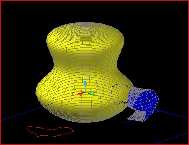

Hallo,
here is a sample of Africa in AutoCAD 2008. I know, that my earth-model has some mistakes :-)
The way to to is a little bit time-consuming, so I only did Africa.
